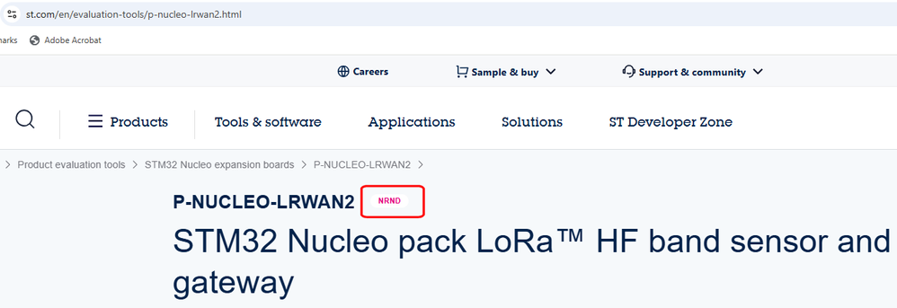

@pmendes03 wrote:I recently bought a P-NUCLEO-LRWAN-2.
Note that this is Not Recommended for New Designs (NRND):
Not least because, as @Tesla DeLorean said, the USI module is obsolete. See this thread (yesterday):

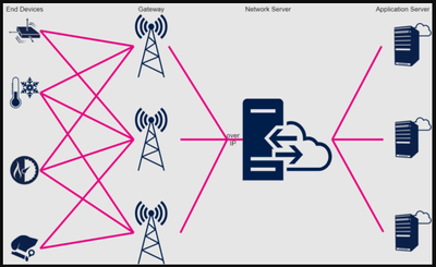

@pmendes03 wrote:I would like to communicate through LORA from the gateway to the end-node and vice-versa, .
That's really not what the Gateway is intended for - a Gateway forms part of a LoRaWAN Network, and expects to connect to & be controlled by a LoRaWAN Network Server:
https://www.thethingsnetwork.org/docs/lorawan/architecture/
If you just want to send stuff between devices, look at the peer-to-peer LoRa examples.
Thanks for this, I only used LORA so far, so this is a whole new concept for me
