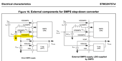

In STM32H757XIH6, is SMPS GND and VSS internally shorted inside the IC or should be shorted externally during layout stage. Snips supporting these are attached.

VSSSMPS should be shorted to GND externally.
