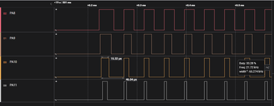

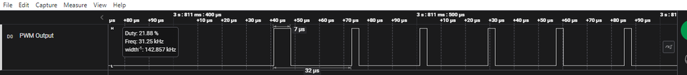

  • I'm trying to generate PWM signal using [ TIM3 channel 3] in NUCLEO-G071RB Eval board.
  • Time period is 28 microseconds and width are 3 microseconds.
  • As you can see in the below [image 1 ]only the first pulse is different or corrupted, which gives 32 microseconds time period and width are 7 microseconds .

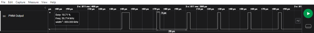

  • From the second pulse , we are able to get the expected pulse as shown below [image 2] Time period is 28 microseconds and width are 3 microseconds.

The output can be observed, as shown in the below image 1.
Pin No PA8, PA9, PA10 and PA11 all are having corrupted/ different pulse width of first pulse.
You can easily reproduce this issue, without making any changes to example code.

From the waveform capture it's not clear whether the leftmost pulse was the first one after reset (and I am afraid it wasn't).
