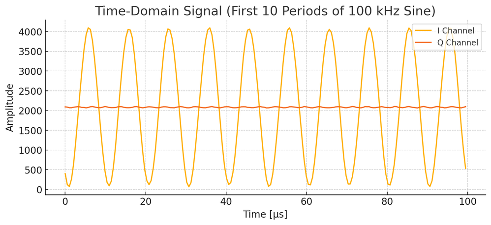

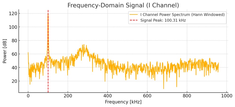

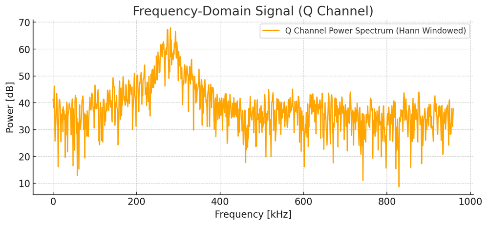

I'm using STM32H755 Nucleo board and I'm evaluating ADC. I'm using 1.92MSPS per ADC sample rate for ADC1 and ADC2. I'm using A0 and A5 pins from CN9. I'm using ethernet to transfer data. My input to A0 (I channel) is 100kHz sine and A5 (Q channel) input is constant 1.6V.
The problem is periodic noise around 320kHz.What might cause that and is it possible to get rid of that? I have read that it might be caused by ethernet connection. I would need ethernet in final application, so would need to solve the issue somehow.

I'm not clear for your description. it seems all pictures show the frequency and time domain from input. How do you use the ADC for data converting?
For the 320KHz noise, please double confirm if it's not related to the input 100kHz signals?

I can see this 320kHz noise even though both inputs are connected to ground, so it is unlikely caused by the signal source.
