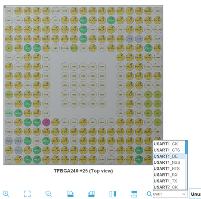

After activating the usart1_de pin, it is now working. I don't know why it was the issue but it has solved the problem.

It is in STM32CubeMx
What do you mean by activating USART1_DE pin? Set? Reset?
But USART1_DE alternate function is available only on PA12 but on the board PA12 is connected to FDCAN and USB, no relation with USART1/RS232
I'm not sure USART1_DE pin is the root cause!
2026-04-28 7:57 AM
Oh sorry, that's the usart clock that I activated on PA8
2026-04-28 7:59 AM
USART clock would only be relevant in synchronous mode?
2026-04-28 8:00 AM
Sincerely I don't why it solved my issue
2026-04-28 8:05 AM
As @mƎALLEm said, it looks like this is just a coincidence - not the actual solution to the problem.
The board only uses PA8 as MCO to optionally clock the Ethernet.
But, hey - it's working now!
2026-04-28 8:28 AM - edited 2026-04-28 8:30 AM
USART1_CK is used in synchronous mode while you are using asynchronous mode.. I don't see the relevance of activating USART1 clock output here.. Moreover PA8 is floating (MCO output to a board connector) on the board no relation to USART1/RS232 hardware!
To me the root cause is not identified yet..
