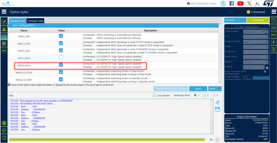

By using the STM32CubeProgrammer to check the value of the XSPI2-HSLV option byte, my problem was resolved.

In my case, after enabling the XSPI2-HSLV option, my problem was resolved.
