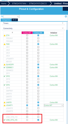

And starting a project from STM32CubeMx based on the STM32H747I-DISCO board, the USB FS is not enabled by default. Only USB HS is enabled:
Hope it's clear now.
