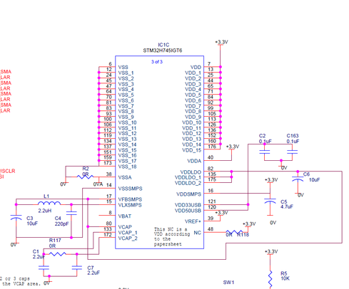

2023-06-22 2:51 AM
This is the configuration I'm using to enable the SMPS, not sure if its correct following the data sheet? It is not very clear.
