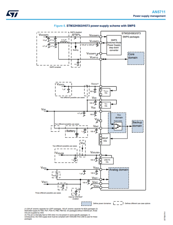

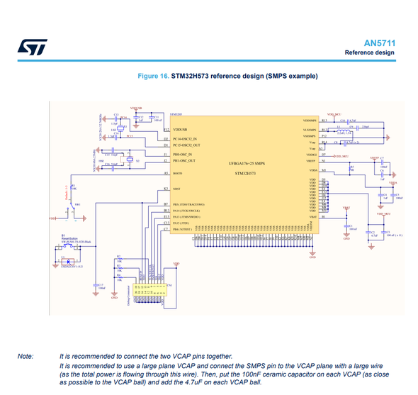

2024-10-10 9:10 AM
Hello @Amit_En_C and welcome to the Community;
Could you please refer to AN5711 precisely Figure 5. STM32H563/H573 power-supply scheme with SMPS and Figure 16. STM32H573 reference design (SMPS example) and check your schematic. Are you use an L1=2.2µH between VLXSMPS and Vcap, it is Required for SMPS packages on VLXSMPS pin.
Note: It is recommended to connect the two VCAP pins together.
It is recommended to use a large plane VCAP and connect the SMPS pin to the VCAP plane with a large wire
(as the total power is flowing through this wire). Then, put the 100nF ceramic capacitor on each VCAP (as close
as possible to the VCAP ball) and add the 4.7uF on each VCAP ball.
I hope this help you!
Thank you.
Kaouthar

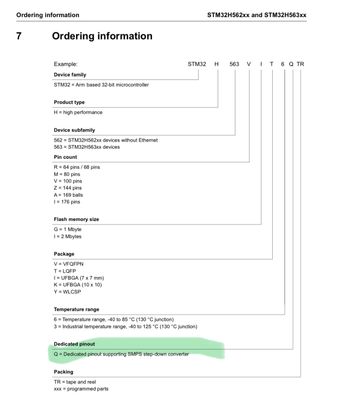

2024-10-20 2:02 AM
Dear @Amit_En_C ,
This is an expected behavior as you have an MCU reference supporting only SMPS. Which is ending by Q. To have LDO you need the part without Q at the end . This option is exclusive and not inclusive and hard coded out from our factory .
Hope it helps you
STOne-32

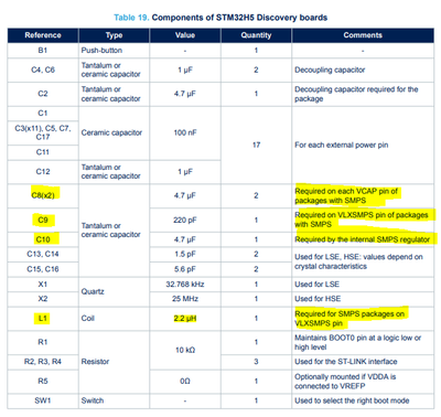

STOne-32 Thanks for your answer !
I see.
I think that the datasheets should be more specific, because - in your picture, it says "Dedicated pin-out supporting "SMPS".
Do I need to figure out myself that if it supports SMPS, then necessarily it doesn't support LDO configuration ?
In addition, in the datasheet they are showing how to make connections for the LDO mode.. very confusing.
