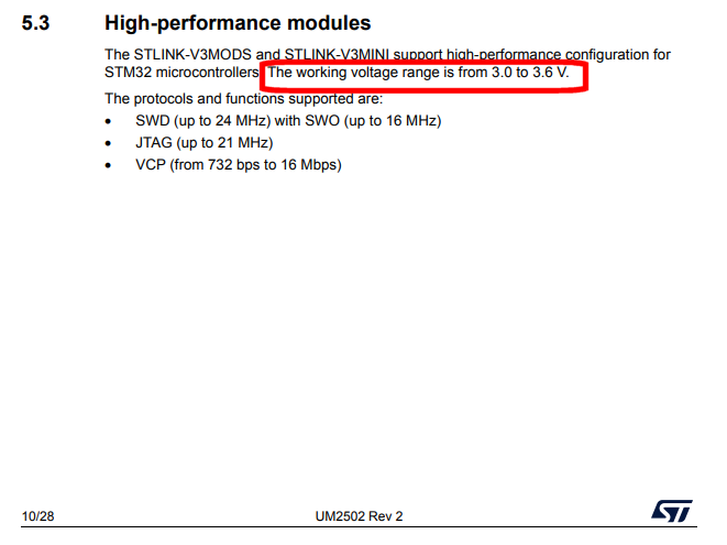

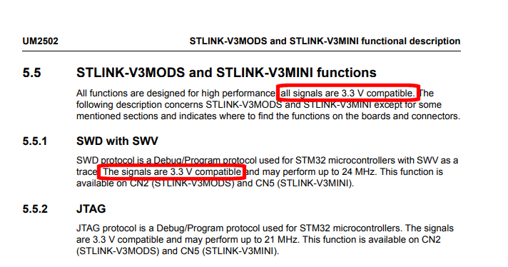

I have a question regarding the compatibility of the STLINK-V3MODS SWD pins with my MCU's SWD pins, which operate at 3.3V. Do I need to use logic level shifters between them, or are the STLINK-V3MODS SWD data signals fully compatible with 3.3V logic levels? Additionally, can I connect them without using logic shifters, and if so, would that be safe for stable operation?

The answer is here:
Your 3.3V falls between 3.0V and 3.6V - so that's fine!
See also:
And:
via: https://www.st.com/en/development-tools/stlink-v3mods.html#documentation
