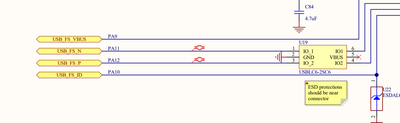

PA11 & PA12 are used by the USB on the board.

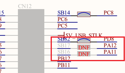

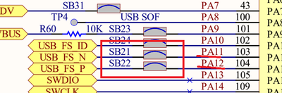

Meanwhile you can play with the solder bridges according to the board schematic:
To remove SB21 and SB22 to disconnect these IOs from the USB hardware part:
and solder SB16 and SB17 to connect them to CN12 connector:
