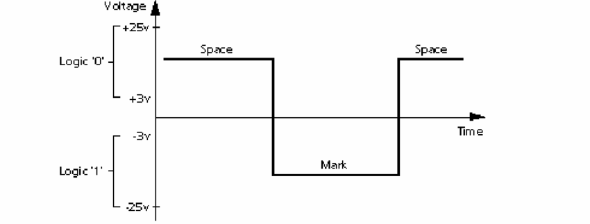

2024-02-02 2:11 AM - edited 2024-02-02 3:58 AM
If you mean by "a voltage level shifter" to replace the transceiver, the answer is no.
This is the ranges for RS232 with negative voltage:
So please use a suitable transceiver.
