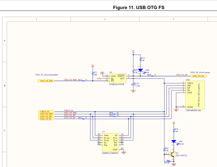

On the STM32F429I-DISC1 board, the power supply is coming from the EN and ENABLE pin connected to OTG_FS_PSO, which is in turn connected to PC4. How can I determine the VBUS power supply on the STM32G0B1RCT6?

You can follow the example provided here STM32CubeG0/Projects/STM32G0C1E-EV/Applications/USB_Host/MSC_Standalone at master · STMicroelectronics/STM32CubeG0 (github.com)
and schematics here MB1352 (st.com)
