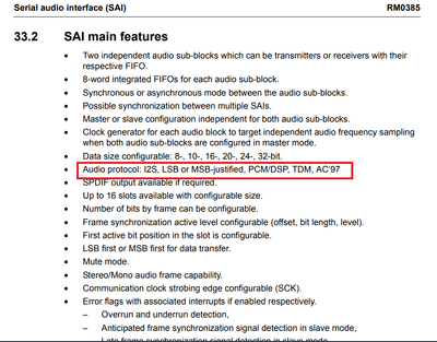

Hello @AMS12345 ,
According to the reference manual, these are the Audio format supported by SAI interface in STM32F746:

Hello @AMS12345 ,
