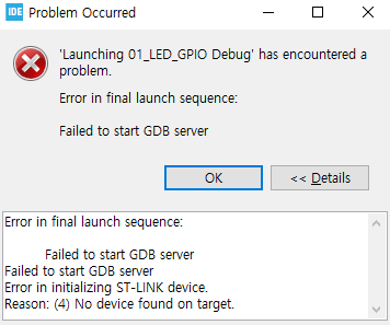

I have the following problem when using the Nucleo board.
I do not have a mini-usb.
So I use to ST-LINK.
However, the following warning message is displayed.
Please tell me the solution.
Thank you for reading.
※ I use to STM32CubeIED.

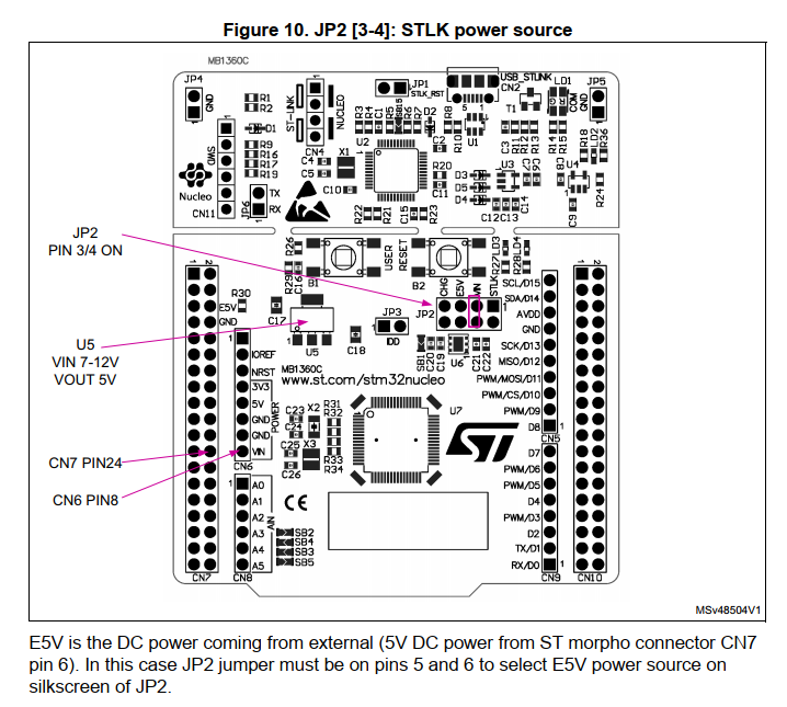

2020-07-28 4:52 AM
Check you power supply. I would suggest connecting to VIN not VDD directly.

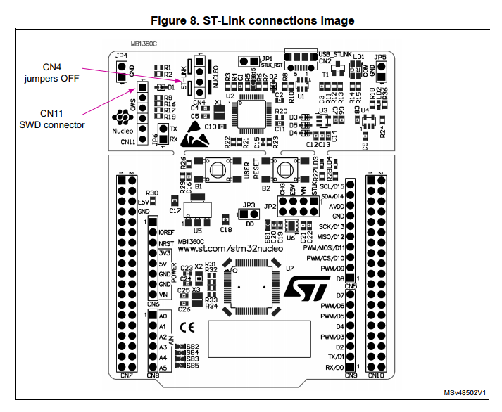

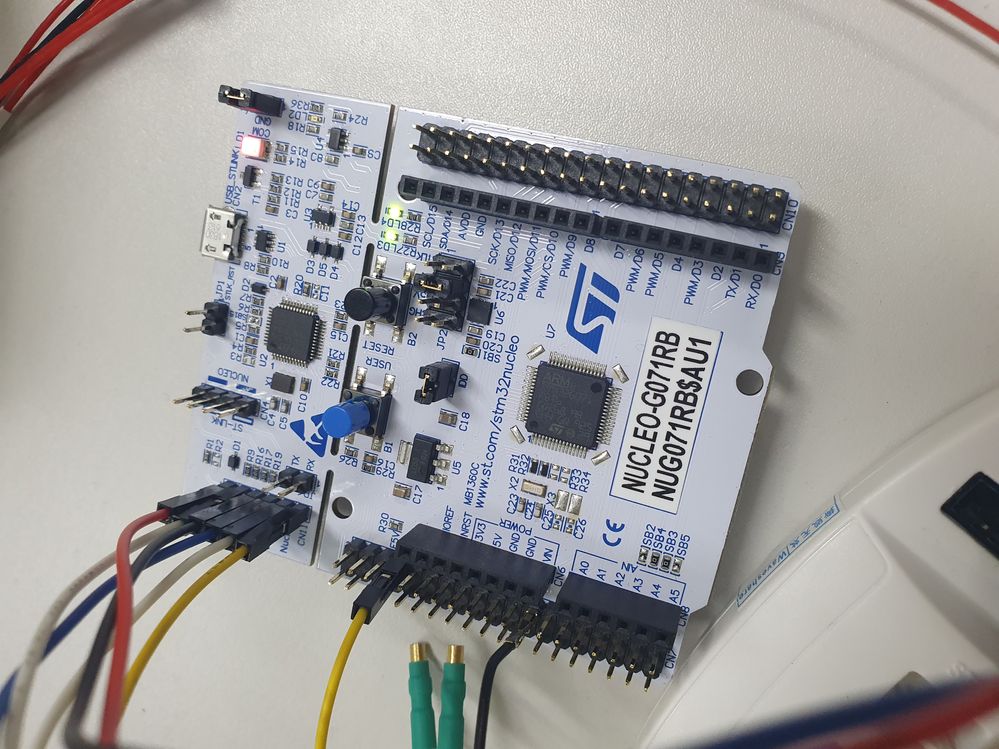

2020-07-28 5:36 PM
Thank you for the answer.
I linked it like the datasheet below.
but it isn't operation.
2020-07-28 5:40 PM
CN11
1 - VCC
2 - SWCLK
3 - GND
4 - SWDIO
5 - RESET
2020-07-28 7:28 PM
Can't in-bound SWD connection via that header, not how it works.
2020-07-28 7:30 PM
That's for OUT-BOUND connectivity.
Review the schematic, understand the circuit..
