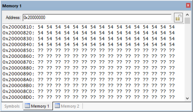

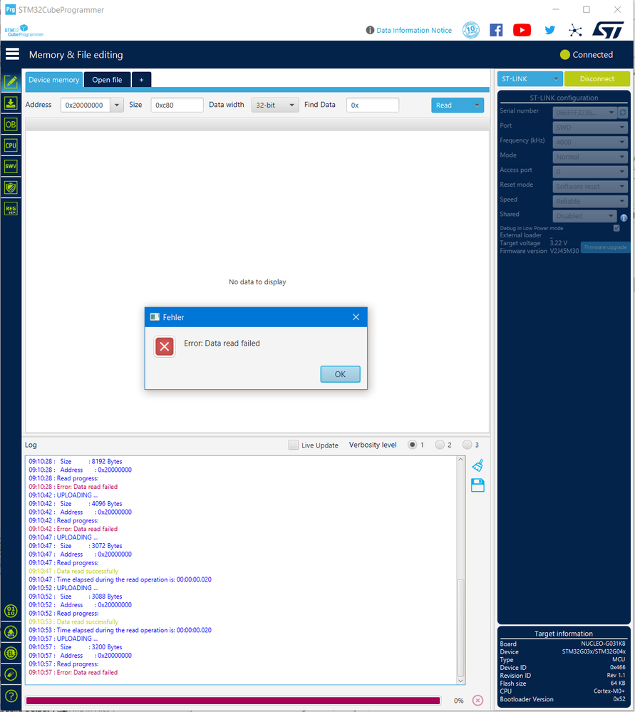

We've got here 3 STM32G031K8 Nucleo. 2 of them had problems with RAM access. 1 works fine at the moment.
For example STM32CubeProgrammer shows by RAM Dump
Keil shows
STLink Utilities hangs by Access of some RAM address.

Hello @CanRF ,
You can try to read option bytes with STM32CubeProgrammer.
Verify at Option Bytes if Read Out Protection is unchecked.
2024-06-22 5:51 AM
I can readout the flash without an problem.
I can readout most part of the RAM.
But on some address I get this error (STM32CubeProgrammer) or '?' (Keil)
I think the chip has a bad RAM.
