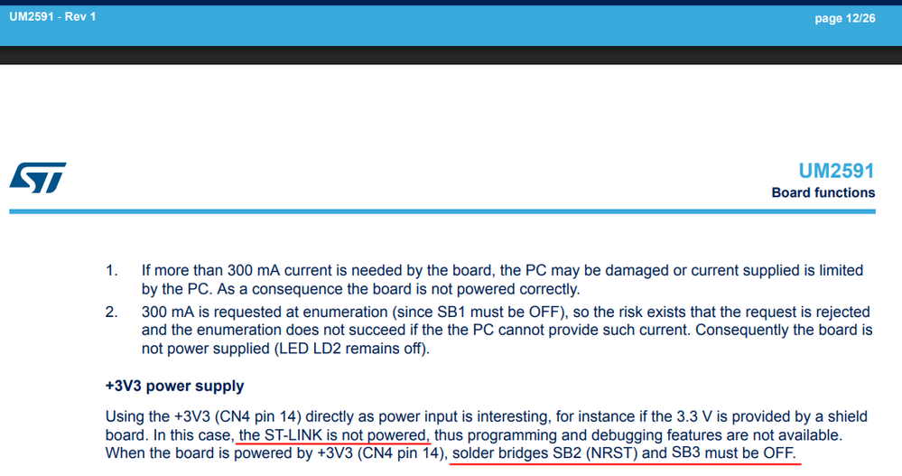

https://community.st.com/t5/stm32-mcus-boards-and-hardware/external-powering-of-nucleo-l031k6-hsi-able-to-run/m-p/663084/highlight/true#M18423
You should break SB2 to disconnect the Reset connection to the ST-Link;
Possibly also SB3 - to disconnect the VCP:
Thanks Andrew,
I did see that comment, although it only seems to apply when powering from the 3V3 pin. Even then it does not make sense looking at the schematic. SB2 is the reset of the STLink MCU and SB3 one of the comms lines to the USB. The design and the manual have drifted apart somehow.
Indeed, the manual does seem misleading/unhelpful in that respect.
But it will apply in any situation where the ST-Link is not powered.
