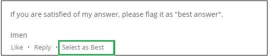

I didn't find a flag with a 'best anwer' caption. So i click on the thumb. You should be proud : it is the first time i do it ;)
Jean in Grenoble (France)

You will find the "Select as Best" flag below in my previous answer.
Imen

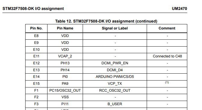

I would like to know how can I find on which pin is connected the user button ! Where must I look for ?

The specific assignments for each pin are detailed in the device datasheet: STM32F750x8 Datasheet , in the Table 10. STM32F750x8 pin and ball definition.
The user button (B_USER) is connected to the PI11.

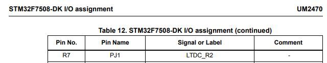

>> I tried to find the declaration of 'gpio_pin_1' with no success (I found it in an example).
Do you mean PJ1 pin ?
Imen

About the user push button : how can I know that its name is B_USER ?
I try to explain my problem with the reset button : in the UM2470 document, I can see on page 17 : "Reset button B2". If I search in the whole document for "B2" I can't find another occurence. But perhaps it is PB2 on page 32 : pin M5 PB2/BOOT1 ? If yes why is it not the same name ? Or if not why "B2" is not written near "J1 NRST Hardware reset" page 31 and/or on the CN6 connector page 23 ?
