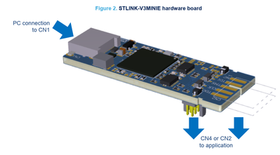

For miniE ( i use also ) :
https://www.st.com/en/development-tools/stlink-v3minie.html
-> read the manual...

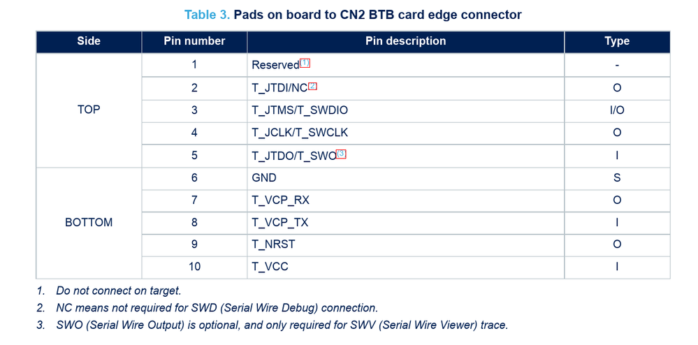

So minimum for swd : GND, VCC , SWD, SWC .
or "full".. , with VCP : GND, VCC , SWD, SWC , SWO , NRST, RX , TX .
+ important :vcc needed to check and show the target supply, so its INPUT to st-linkV3 , not giving out power !
Your target cpu needs to be powered from separate/other supply, st-link needs vcc connected to check target voltage.
