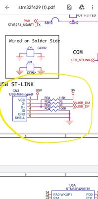

>The board is getting heated and st-link not detected error
What is getting hot ? F429 , F103, or both ?
(Typical for a fried cpu is "heat", maybe overvoltage on a pin or by ESD ... )
just see a "BlackPill" circuit, attached, for F4xx, this is what you want ;
a working st-link , you need then.
Just...not the full JTAG , only swd/swc is fine:

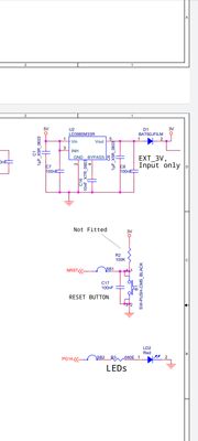

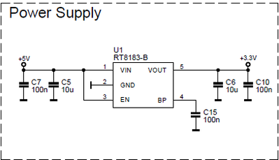

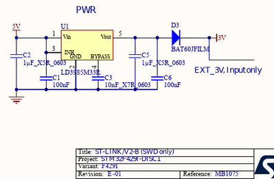

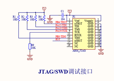

Where is the 3v3 regulator ? USB -> has 5V , so how cpu is powered ?
2024-07-20 5:41 PM
2024-07-20 11:14 PM
But its not in the circuit - i cannot see it...
like this:
on F429 is here 3V supply:
2024-07-20 11:56 PM
It is there in page 3 right side.
2024-07-21 12:48 AM
Ooooo - sorry, i only looked on page 1 (didnt see the others)
2024-07-21 12:58 AM
Your name topic custom is little out... You copy schematics seems ok except U5V and 5V , but when board some days working ... Your explain heating is amateur, measure with DC 3V 5V and currents... Your STMs seems is dead and need new . Way remove from board and place into other is next ... STLink part on custom boards isnt necessary.
