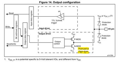

I want an I2C Scanner program for STM32F103C8T6 Blue Pill board. i will use external pullup for the i2c clock and data, because the voltage of the devices i am going to scan is 1.8V. The software should find the address of all the devices connected in the bus and return the address to the pc through UART port. default three i2c ports are not true open drain so i need alternate solution.
2024-07-24 12:27 PM
Why do you think that?
Pins can certainly be configured in open drain mode, as referenced many times in the RM.

2024-07-24 10:58 PM
/* USER CODE BEGIN MX_GPIO_Init_2 */
/* Configure I2C GPIO pins: PB6 (I2C1_SCL) and PB7 (I2C1_SDA) */
GPIO_InitStruct.Pin = GPIO_PIN_6 | GPIO_PIN_7;
GPIO_InitStruct.Mode = GPIO_MODE_AF_OD; // Open-drain mode
GPIO_InitStruct.Pull = GPIO_NOPULL; // Use pull-up resistors
GPIO_InitStruct.Speed = GPIO_SPEED_FREQ_HIGH; // High speed
/* USER CODE END MX_GPIO_Init_2 */I modified the pin as open drain, i used logic analyzer to measure the siganal but it is automatically pulled up.
2024-07-25 5:49 AM
I don't understand why this is an issue. SDA/SCL should be idle high.
2024-07-25 5:55 AM
You shouldn't need to do that - it should be automatically handled by CubeMX when you enable I2C
@ctanto333 wrote:
I used logic analyzer to measure the signal but it is automatically pulled up.
Yes, having pullups is a fundamental requirement of I2C - the lines must be pulled up!
