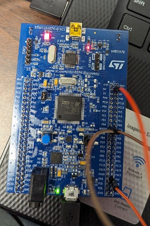

Below is a picture of the board with the connections:

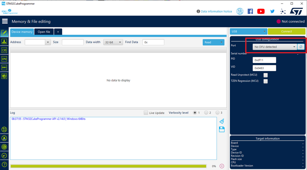

When I open the STM32CubeProgrammer it shows DFU not detected.
Any insight as to what I am doing wrong?

Check NRST solder bridge between ST-LINK and F407 is disconnected.
Perhaps also power the North USB connector, you want the 8 MHz MCO clock from the ST-LINK for the F4 USB to function

Looking in the AN2606 Application note, I needed Pattern 1 to activate the bootloader.
I needed to pull Boot1 to ground. Before I was only jumping Boot0 to VCC.
