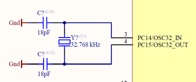

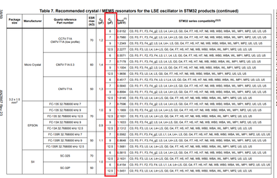

Need to re-check this part of LSE:
Did you check if the crystal is compatible with the STM32? did you calculate the gain margin based on the crystal characteristics and the load capacitors?
Read How to select a compatible crystal and load capacitors for STM32 with layout guidelines
18pf CL looks a bit high compared to the CL recommended for LSE for STM32 in the AN2867 :

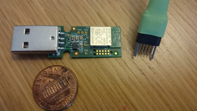

You don't have to provide a full-sized header - could be just test points accessed with "pogo pins"; eg,
See https://www.tag-connect.com/ for that particular connector.
The absolute minimum for SWD is just 2 connections - data & clock - but it's best to also include RESET.

Thank you. I was using a 32.768 kHz ±20ppm Crystal 12.5pF 70 kOhms 2-SMD, No Lead. I will replace it with an FC-135R 32.7680KA-AG3 and use an 8.2 pF Capacitor.
