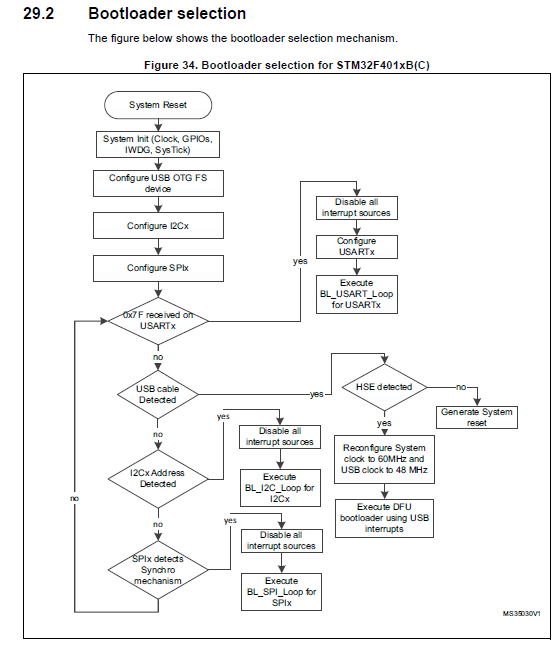

Note that F401 starts up allways with 16MHz RC oscillator. (you can refer stm32f401 datasheet chapter 3.11 clock and startup), and HSE is activated after software sets the right registers, in normal bootup. Now you have empty chip, HSE and also 32KHz LSE stays off, thats normal.
However, if the system bootloader is activated with BOOT0 and BOOT1, also the HSE oscillator is activated when bootloader tries to establish USB connection if USB is detected. (app note AN2606, cd00167594-stm32-microcontroller-system-memory-boot-mode-stmicroelectronics.pdf).
So it seems that your problem is now in the USB detection phase or in actual HSE oscillator circuit.
You can check also an3156 to get better understanding about USB DFU connection.
Setting up SWD connection will certainly help you to debug problem, since you can then download programs and test for example that your oscillator circuit works. Who knows if there is for example wrong size capacitors on the 8MHz crystal installed and that is now preventing DFU USB connection since HSE is not working.
But USB DFU connection will also work with empty processors, it does not need any customer code to the flash. That is sure

From there we went back to the Notice and my friend found in the DOC RM0368 that BOOT 1 should be connected to ground! The PB2(28) pin is in fact the BOOT 1 pin that should be connected to ground... so the product made contact.
After checking, on nucleo this pin is not connected to anything... no pulldown, no strap... but still the MCU starts in Bootloader Mode on nucleo. It is apparently an error on the development board and it works by chance... If someone has an explanation? I'm interested!

Hello Antonie. Good that you finally found the root cause. Since most IO pins (including PB2) are floating during/after reset,even longer trace capacitance or leakage current on the Nucleo board can keep the level enough low so it boots in system memory boot space. I would not call it an error since Nucleo is not specified to demostrate USB DFU usage, it is just a general purpose development board.
Note also that it is enough to have pull down resistor on Boot1, and it can be still used as GPIO pin after reset. Boot pins are sampled in 4th Sysclk rising edge after reset.
Generally speaking, both of these boot pins could have weak internal pulldown, maybe so that it activates only short perioid of time after reset. That would save peoples lots of confusion :grinning_face_with_sweat:
