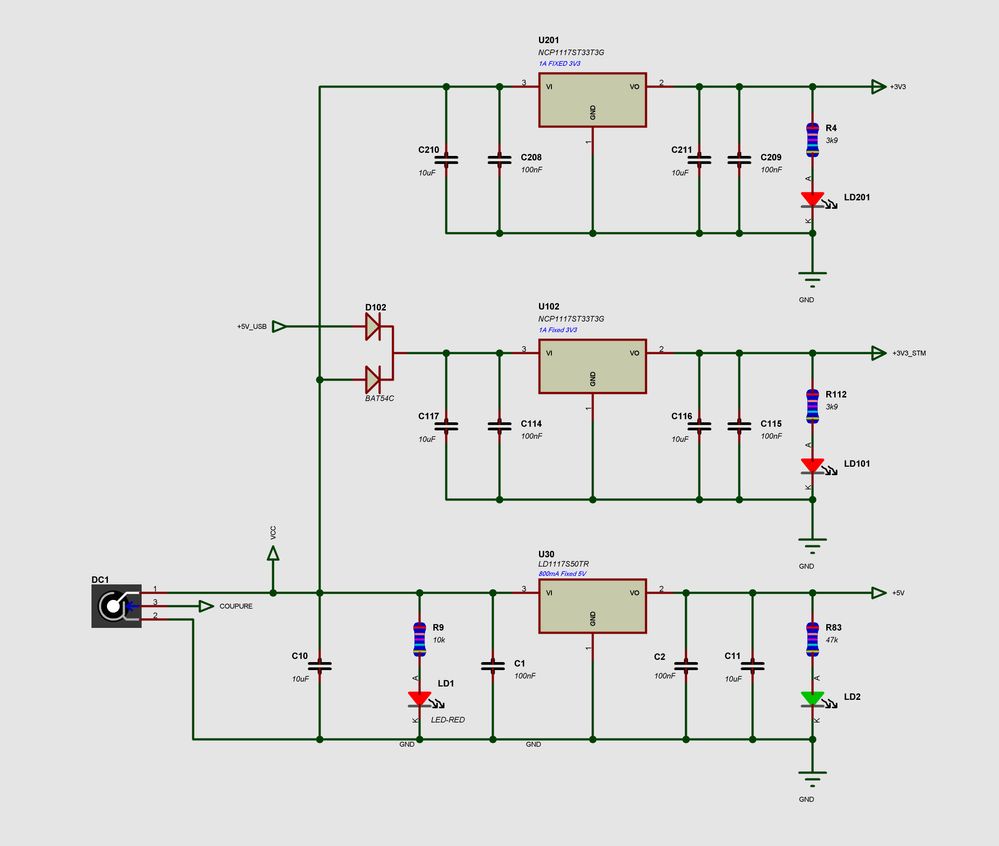

Where does the 3.3 voltages comes ? If from usb, then test so it is present before usb is plugged to pc. In some cases order of power up - usb plugging has been vital.
2023-05-16 5:55 AM
Also, the MCU may be in a Hard Fault state because the external oscillator does not start at the given time. The only way is to connect the STLink from the Nucleo board and see what happens.

The usb provides the 5V and then a voltage regulator is in charge of lowering the voltage to 3.3V. I join you the shema of the power supply.
