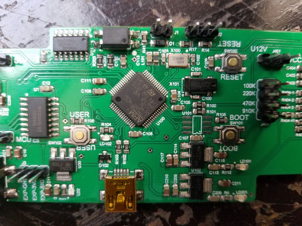

So I programmed a test code on nucleo which works well. For my final project, I need to integrate only the microprocessor, so I cut the V-Link card of the nucleo and used the DFU Mode to program the chip via USB. Everything works fine, I added a "BOOT" button that allows me to pull pin 60 (BOOT) to 3.3V and I can program the STM via STM32CubeProgrammer.

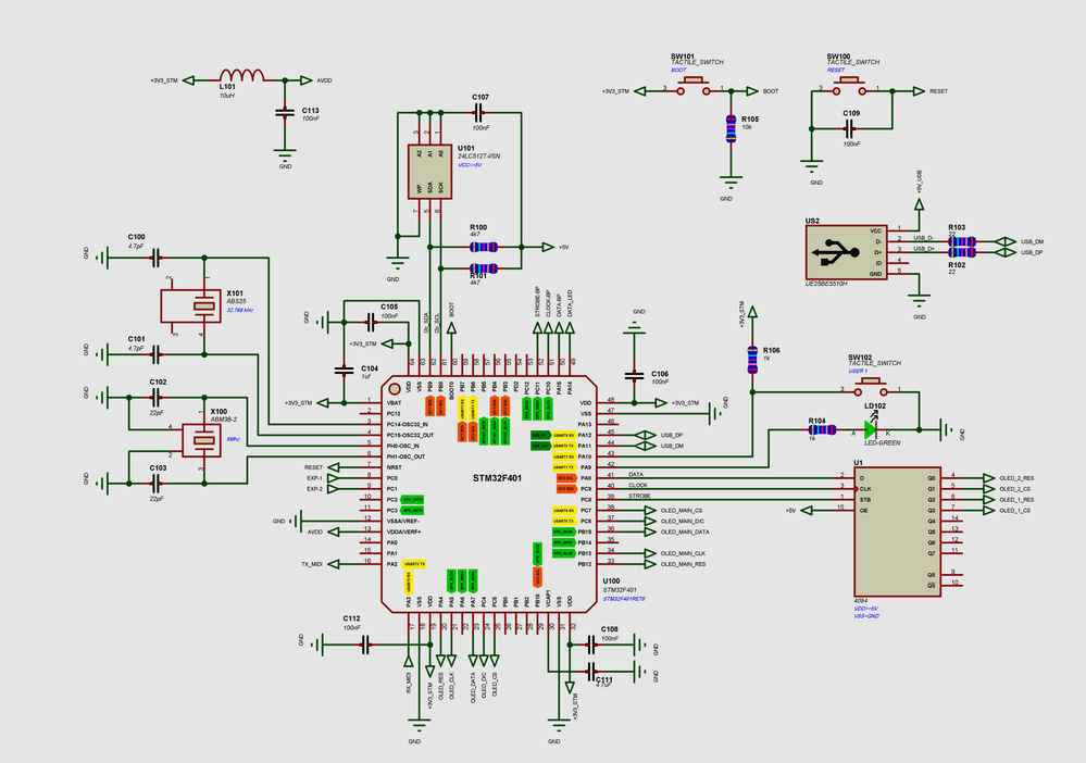

In a second step, I created a test board following the Nucleo schematic indicated in the manual. I just wanted to reproduce the same assembly as on the Nucleo board but with my PCB.
The PCB was assembled by the PCB manufacturer with a Pick & Place.
When I turn on my custom board, I have all the power supply pins receiving 3.3V, I put all the decoupling capacitor as shown on the diagram, check all the connections to the tester, but despite that, the chip does not seem to start. Impossible to start in DFU mode to load the 1st program.
I attach a schematic of my assembly and a picture of the PCB.
I have spent hours reading and searching the various forums but I have not found why my MCU does not boot!

Indeed after thinking that the error comes from a soldering defect, I realized that the DFU mode only start when the MCU was "bathed" in the Flux cleaner (Product to clean the soldering). After 2 days of headache to check everything, re-soldered, tested, change the quartz, the capacitor .... In short still nothing, the MCU in bootloader mode does not work if the condition of being bathed in this liquid....
A friend then made me notice that the product in question must be conductive...
After the product, it was my fingers that in contact with some pin allow me to start in DFU mode... So we searched on a capacitive problem, design defect, ground plan.... Nothing yet!
From there we went back to the Notice and my friend found in the DOC RM0368 that BOOT 1 should be connected to ground! The PB2(28) pin is in fact the BOOT 1 pin that should be connected to ground... so the product made contact.
After checking, on nucleo this pin is not connected to anything... no pulldown, no strap... but still the MCU starts in Bootloader Mode on nucleo. It is apparently an error on the development board and it works by chance... If someone has an explanation? I'm interested!
Conclusion, I followed the official scheme and there was a connection missing!
Everything is working fine for the moment, it seems I connected PB2 to GND!

Try to pull PB2 down. It is Boot1 and should be low when entering system memory bootloader.

I'll try but it seems surprising because on the nico PB2 is not connected to anything, not even to a pull-down resistor.
I also checked with the tester on the nucleo.
In the documentation, there is no BOOT 1 for the MCU LQFP64.
Only the LQFP48 which is the ST-Link has a PB2 pin (BOOT 1) which must be connected to ground.
