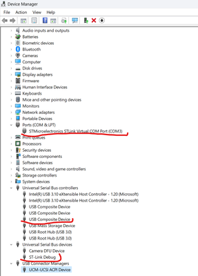

When I plug my STM32F3DISCOVERY board, I get 3 new devices: ST-Link Debug, USB Composite Device and STLink Virtual COM port (COM3). Shouldn't the general Virtual COM Port be capable of transmitting UART messages, or do I need exactly VCP UART?

COM3 is your VCP.
Putty, Docklight or even the built in serial terminal that STM32CubeIDE has will work to receive from the MCU.
