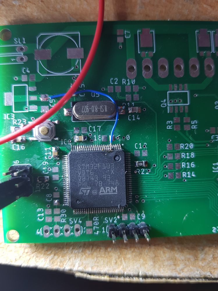

I have designed a custom board, i have attached the schematic of it. My problem is that I have an ST-link v2 and i cant connect to it, i get target not found. Is my schematic correct or I have missed something? I have power and ground on all necessary pins on my board. I connected VDD, GND, SWDIO and SWCLK to my board from the ST-link, I used pins 1, 7, 9, 20. I tried to swap the pins of the data and clock signals, and all the settings in the ST-Link utility. My programmers firmware is up to date.

I think this is the case, I attach a picture. But I think that I confused it. I hate these on concrete situations, in the datasheet I have seen only one circle on the top of the IC. And on mine there are 2.
2019-10-16 3:27 PM
That chip is upside down.
With the text right side up, pin 1 is at the bottom left on the chip.
Agreed, it's confusing with two marks.

Thx, for the fast responses. I have any chance that my IC could work? It doesnt heated up or consumed high currents. Anyway I order some new pieces.

Orientation FTW, I just need to redeem my points
2019-10-17 10:22 AM
Yes, today I got it off and soldered in the right way. And I can communicate with it through SWD. Thanks for your answers! I test everything with current limit of 10mA, and this consumed under it with the wrong orientation too.
