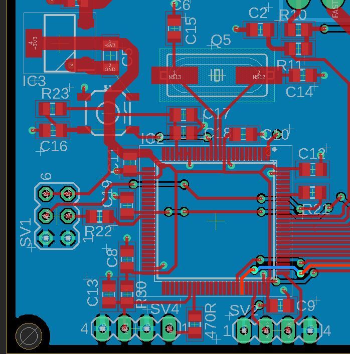

Hello!
I have designed a custom board, i have attached the schematic of it. My problem is that I have an ST-link v2 and i cant connect to it, i get target not found. Is my schematic correct or I have missed something? I have power and ground on all necessary pins on my board. I connected VDD, GND, SWDIO and SWCLK to my board from the ST-link, I used pins 1, 7, 9, 20. I tried to swap the pins of the data and clock signals, and all the settings in the ST-Link utility. My programmers firmware is up to date.
Best regards,
Attila
2019-10-16 3:27 PM
That chip is upside down.
With the text right side up, pin 1 is at the bottom left on the chip.
Agreed, it's confusing with two marks.
2019-10-16 8:28 AM
Check the voltages
Check part orientation
Check level on NRST pin
With BOOT0 pulled high try talking to the ROM based System Loader, via USART1 PA9/PA10, at 9600 8E1 send an 0x7F data byte, and check for response. Use something like RealTerm which can send hex bytes.
2019-10-16 8:53 AM
VBAT should be connected to VCC.

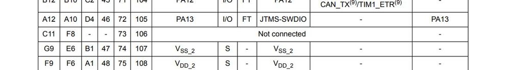

Is pin 73 really NC on the package? Seems odd.
2019-10-16 8:57 AM
I have checked the voltages, all ok. The part oriantation indentation is in the up right corner. For some reason the NRST is 0.26V, but if I put a wire I can bring it up to 3.2V. But still no luck. I tried with an arduino the BOOT0 method with 0x7F data byte. I checked the answer on the oscilloscope and there was some response data.
2019-10-16 8:59 AM
I tried that too, with no luck. If Im correct it is NC, I attach the datasheet.
2019-10-16 9:00 AM
If NRST wants to be 0.26V, voltages are not okay. Indicates a problem in your power supply scheme somewhere.
2019-10-16 9:19 AM
This is akward for me too, and the second odd thing is that PA2 is shorted to VDD in the interior of the IC. But I measured the voltages on all the pins and are ok.
2019-10-16 12:39 PM
Did you measure *directly* on the pins? I am aiming at bad solder joints.
Did you measure also VDDA/VSSA?
Is the text on the chip bottom-up?
2019-10-16 1:28 PM
Definately sounds like you've got the device rotated.
NRST will be low absent a VDDA supply on the correct pin.
Show clear, in focus, high resolution photo of the chip on the board.
Don't confuse the mold ejector marks for pin 1 designation
2019-10-16 3:20 PM
Yeah. I have thinked about this, and I measured all the voltages on the top of the pins, near the package with really thin probes. I measured all of the vdd/vss pins. No, the text is up-buttom.
