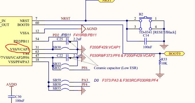

Hi all,
Is there any VCAP required for this IC ?
Please provide your comment.
