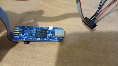

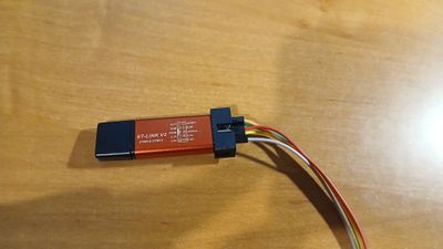

Here is my ST-LINK V2 (the first picture), but I guess it is a counterfeit ST-LINK, but according to that I ordered a new ST-LINK. It is STLINK-V3MINIE (the second picture) and this is the original one. I connected that in the same way, and I am facing the same issue. The microcontroller on my board connected via STLINK-V3MINIE is not responding. It is really strange, because I have another board from my previous project, where I have a very similar circuit and there is STM32F030F4P6 and there everything is good - the microcontroller responds via these STLINKs. The only idea that I have for now is that the ICs were somehow damaged during an assembly in JLCPCB, but I am not sure about that.

Sorry for the late response. After many re-checks of almost everything that could cause the problem, I have finally solved it. As @Tesla DeLorean mentioned, it was an electrical issue. I made a very *** connection. It was due to too long and too weak wires between my PCB and ST-LINK. I used shorter wires. The second reason was that counterfeit ST-LINK was disconnecting at totally random moments. Now I know that buying any counterfeits is a bad idea.
