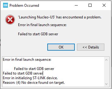

Impossible to launch the debugger with the following configuration:
See log files
STm32cubeProg 2.8.1 can connect to the board successfully.
What is wrong ?
BUG ?

2021-11-02 9:21 AM
maybe you didnt closed the STM32CubeProg session so the gdb server is busy? it happens to me sometimes
2021-11-02 10:43 AM
I admit that I have also made this mistake more than once, but not in this case.
thanks
2021-11-02 11:12 AM
Can you try to decrease the STLink SWD frequency.
If not better, can you try with OpenOcd gdb server.
Rgds,
Laurent

2021-11-05 3:05 AM
Indeed, decreasing the frequency of the St-link seems to improve the connection, but it is not very stable.
The frequency of successful connection varies between 8Mhz and 21Mhz !
I have not encountered this problem on other Nucleo board references.
Regards
Frederic
2021-11-05 3:16 AM
Stay below the 8MHz as specified in the errata: https://wiki.st.com/stm32mcu/wiki/STM32CubeIDE:STM32CubeIDE_errata_1.7.0#STM32U5
The lower the better stability.
2021-11-05 3:36 AM
thank you for this information,
This problem is therefore already known
I didn't think about reading this errata sheet, sorry
