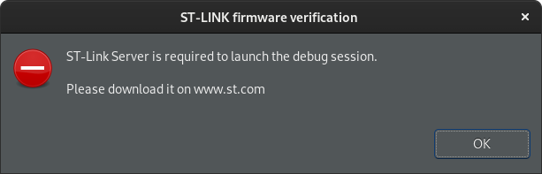

After I update STM32CubeIDE from 1.3 to 1.4.2 I can not start debugging process.
It says ST-Link server required, but I set Open-ocd for debugging.
What I cat to do? Please, help to resolve a problem.
My OS OpenSuse thumbleweed.

I suggest you reinstall STM32CubeIde 1.4.0 from installer (it embeds also the STLink Server install).
Then, you can update to CubeIde 1.4.2 to have the latest version.
2020-09-16 6:29 AM
And see the answer of Miyago in this post https://community.st.com/s/question/0D50X0000BsQkvySQC/installing-stm32cubeide-on-opensuse-tumbleweed
He said :
I use OpenSUSE leap 15.1 and had the exact same problem as you with the rpm bundle.
I used STM32CubeIDE Generic Linux Installer instead and it worked without any problems.
