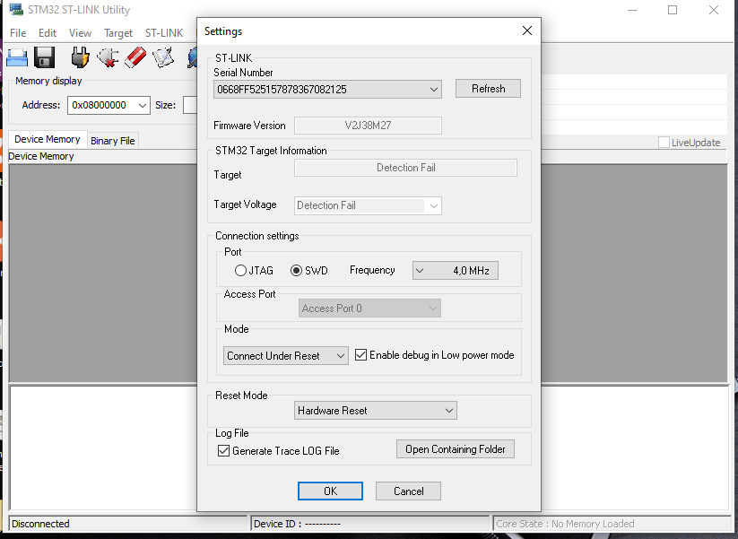

2021-10-20 8:38 AM
So I used the STLink Utility App and these were my settings, as soon as I press Okay I get the following :
Then when trying to erase the chip, it gives the same error. I watched a few videos and most of the poeple just press the reset button (which I have on the board) and release it again after pressing erase chip, but this also isn't working, because it doesn't even want to connect to the chip, but I can update the firmware on the chip using STLink Utility.

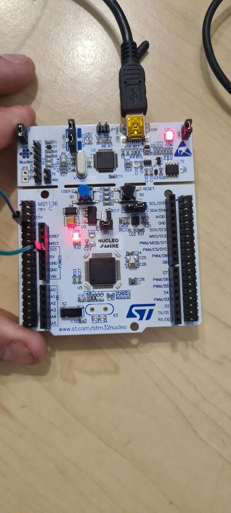

2021-10-20 9:05 AM
So this here is my board, my NRST Pin is just above my 3V3 Pin, so I am not sure what you mean by holding NRST low briefly, and should I be doing anything else in the programmer at this time?

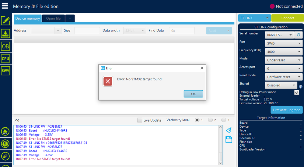

2021-10-20 9:08 AM
These are the settings in my programmer but when I click connect it shows that it is picking up the board in the log but it keeps showing that the target isn't found
