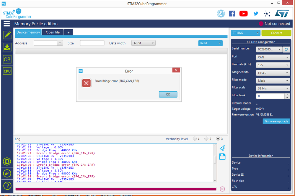

Getting a "Error: Bridge error (BRG_CAN_ERR)". Can't find any documentation about it.
The StmLinkV3 is able to program the Nucleo (Stm32H743) via SWD fine.
In the screenshot's log section, the first message shows that the StLink doesn't detect the target's vcc.. so I had to connect the SWD cable between them, which kind of defeats the whole purpose of the CAN bootloading.. however even after it detects the target vcc, it fails to connect due to the BRG CAN ERR. I've tried all the different baud rates with no luck.
I have the Nucleo in bootloader mode (BOOT0=3.3V), with the STLink can bus (CN9 Pins 8/9) directly to the Nucleo's Can lines (CN9.25/27), crossing RX/TX.. although I've tried both ways. Actually, I get the error message even without connecting the TTL can lines to the target.
I'm using Stm32Cube v2.4 with an StLinkV3 MB1440B (firmware V3J5M1B3).

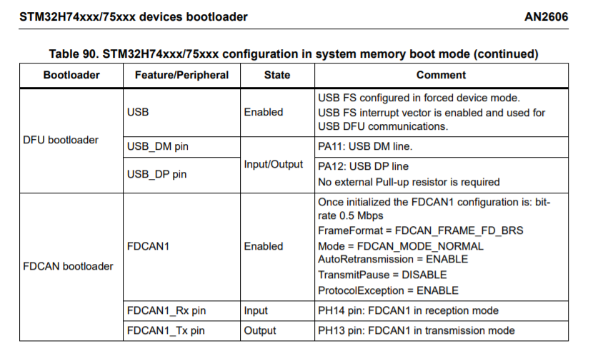

The Reference Manual doesn't list it, but it does refer the reader to AN2606.. and in that document, it shows CAN bus is a supported bootloader for the STM32H74xxx/75xxx
Also, the StLink reports that error with or without connecting it to the target device. Is that normal?

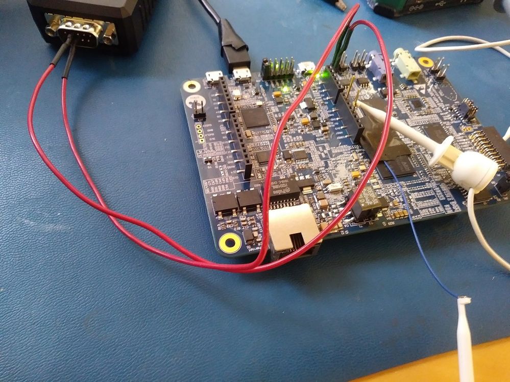

The St-Link-V3 has the JP7 (CAN_ON) jumper installed, its CN5's CAN_TX and CAN_RX pins are connected to an external transceiver (SN65HVD230). The transceivers H/L bus is connected to the STM32H745I-DISCO's CN11 Pins 1&2. The ST-Link V3 "CAN_VCC" is tied to VCC with the GND common to the DISCO, TRANSCEIVER and ST-LINK.
Stm32CubeProgrammer (v2.4) shows it has an error connecting to the DISCO via CAN bus. The GUI also reports 0v for the Target VCC, presumably because the interface is not SWD? In any case, I tried connecting the ST-Link V3's "T-VCC" to CAN_VCC but it did not make a difference.
How can we use ST-Link V3 to bootload via CAN bus the STM32H745I-DISCO?

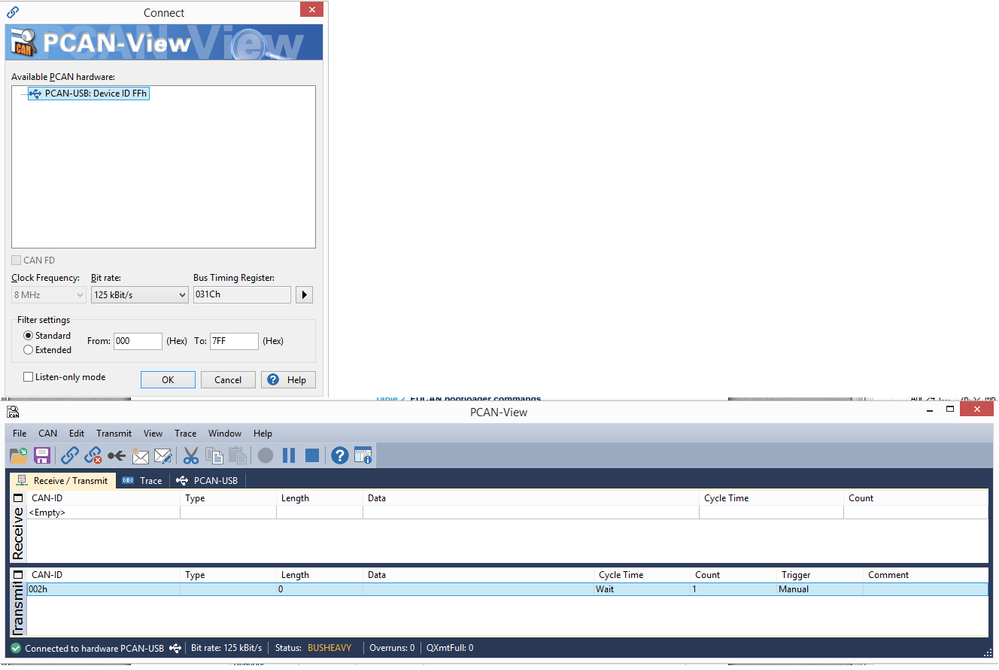

But as a test, I tried sending the chip: 0x79 id (no data bytes) at a 500khz bit rate, from a Peak-USB device (instead of from the stlink) but like St support.. no response.

I verified the H745's ID reported at address 0x1FF1E7FE is 0x90.. which suggests the CAN bootloader is supported.
Unfortunately, despite using the Peak-USB to send commands listed in the application note .. like ID=0, ID=1, ID=2, ID=0x79.. none of them elicit a response from the chip. The GUI goes from OK to BUSHEAVY.. presumably because it's retrying due to no acknowledge.
