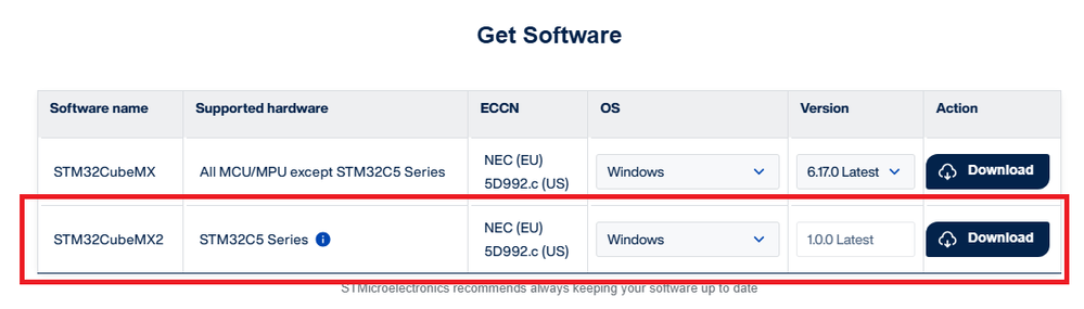

2026-03-16 5:26 AM - edited 2026-03-16 10:39 AM
New Knowledge base article just dropped:
PS:
And another:
PPS:
In Developer News:
STM32Cube Ecosystem for STM32C5 series
Introducing STM32CubeMX2, a new flavour of STM32CubeMX tool
2026-03-17 12:26 AM
2026-03-17 2:08 AM - edited 2026-03-17 2:08 AM
Keep an eye to the list of articles with label STM32CubeMX2. You can subscribe to get notification about any new article there.
-Amel
