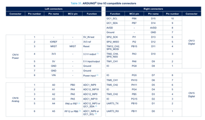

You can use the UART3 on the arduino connector pins:
