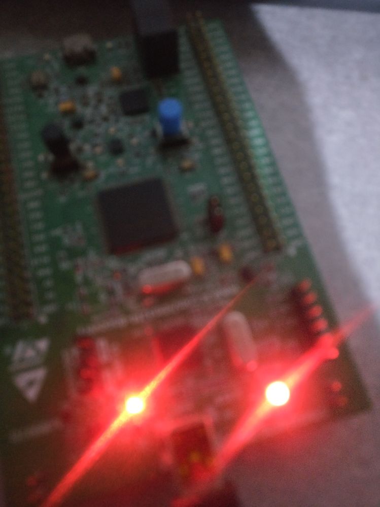

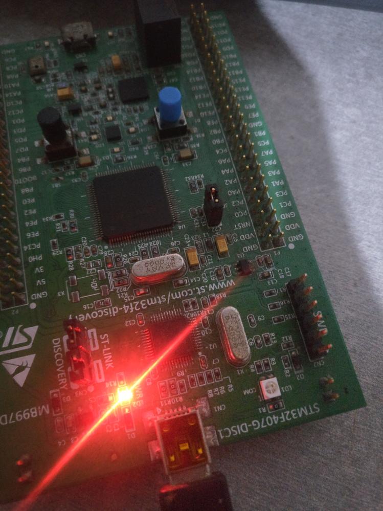

The built in STLink on STM32f4 board is not working. I have used this board for several months and suddenly the STLink is not working.
ST32F4 discovery board - MB997 D 01
In windows when I connect the board, it shows the error 43 (device descriptor failed). And in the ST Link the LD1 blinks red. The STLink does not get identified by STLink utility.

The code running on F4 does not have an effect on this. I tried removing the STLink jumpers and connecting the STLink to the PC and the same error occurs. I flashed the F4 using an external STLink and the board was working. so there is no issue with the F4.
