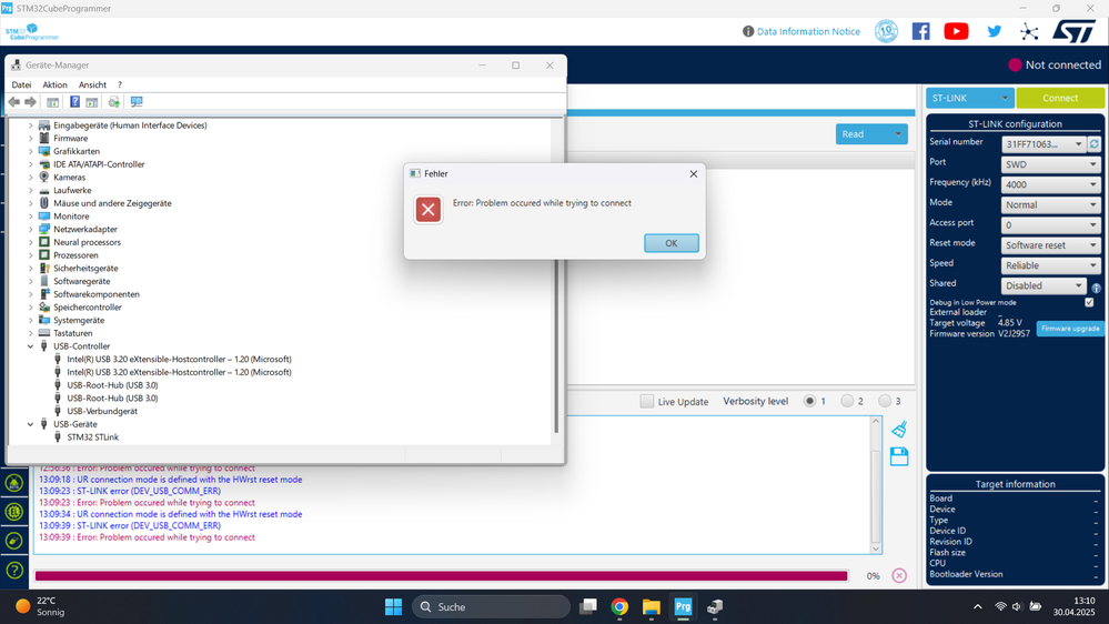

I have tried all my USB ports in my Laptop, used a different Laptop, and tried 3 known working cables, both boards are powered while attempting to connect. I have now found a mistake in my wiring and have changed that. I don't have a pinout of the scanner unfortunately but I have connected like the manufacturer wants me to connect.
ST-Link Scanner
SWDIO SWD
SWCLK SCL
VAPP 5V and my power supply
GND GND and power supply ground
I am using STM32CubeProgrammer and I get this from the log
13:21:54 : Start STLinkUpgrade...
13:22:23 : UR connection mode is defined with the HWrst reset mode
13:22:28 : ST-LINK error (DEV_USB_COMM_ERR)
13:22:28 : Error: Problem occurred while trying to connect
as well as a popup, but I can see the ST-Link in the Task Manager the whole time.

Thanks, that was the issue as well as I didn't think there was a read-write lock on the board that I'd have to clear before connecting, but now it works.
