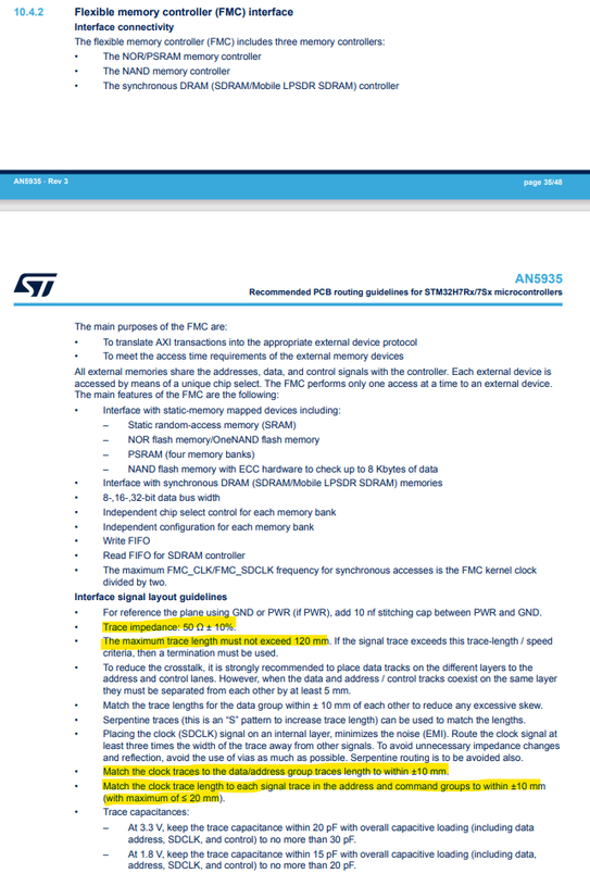

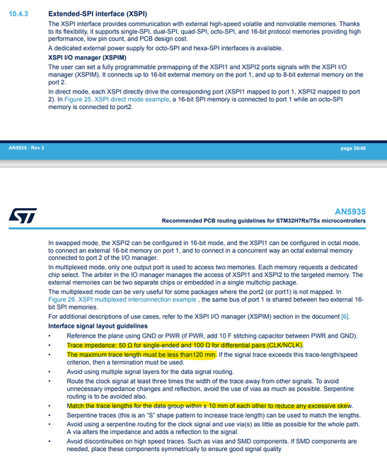

Hello @Kaushik1;
For XSPI and FMC interfaces signal layout guidelines to connect external memories, I recommend you to look at AN5935 section "Recommended PCB routing guidelines for STM32H7Rx/7Sx microcontrollers"
I think this application note and the STM32H7S78-DK schematic board can help you.
You need to run a signal integrity simulation on the PCB using ibis models of the STM32H7R7L8H6H.
Some guidelines on how to use external peripherals to perform board-level simulations with the signal integrity software is described in "High-speed SI simulations using IBIS and board-level simulations using HyperLynx® SI on STM32 MCUs and MPUs" application note.
