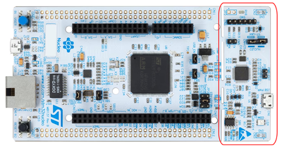

The Nucleo-F429 does have the break-off ST-Link:

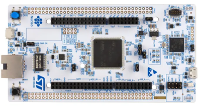

The Nucleo-H775 does not have it:
