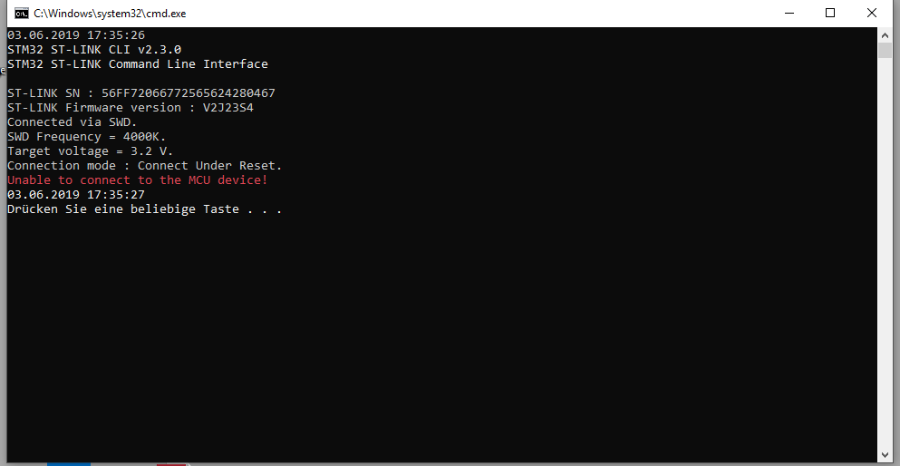

Sorry my bad. I thought i copied the error into my question:
Here it goes:
When i excecute this cmd the MCU is restarted. So "connect under reset" seams to work.
I did try the same using ST Link. The ST Link tool works fine
Output looks pretty much the same to be, except one is working and the other not. :(
As you said, i tried JTAG (with STM32 Link Utility) but this did not work. I'm not sure if SWD and JTAG are hardware compatible though ?!

2019-06-04 1:44 AM
Thx that was indeed the right answer. After upgrading mit ST Link CLI the device was found.
