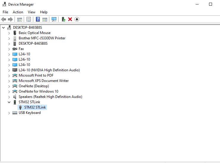

Like the title says when I connect an ST-link to a computer to try to program an NRF52 through an arduino with it it won't show up on COM port but can be found in device manager under "USB devices" as can seen by this picture:
How do you fix that problem and make the device appear as a COM port?

Does your ST-Link V2 have a VCOM function? If not - this is normal, not a problem.
The usual white ST-Link v2 dongles do not have VCOM. Bring your own USB to TTL UART adapter.

Please select the "STM32 STlink" in dev. manager, then click View-> Devices by container. Post the picture.
-- pa
