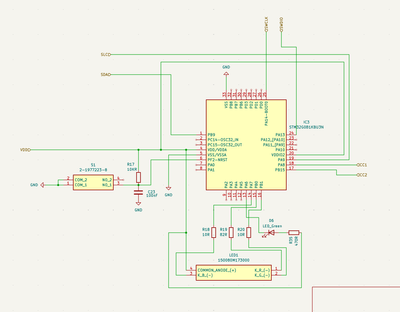

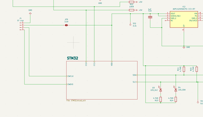

Show a schematic of your STM32 connections.

1. In your schematic I see no RST connection to the ST-Link
2. Is the Jumper JP9 for 3.3V to ST-Link closed?

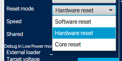

1 - Yes, there is no RST on a schematic (didn't know its required). But the wire is added to RST pin on STM32. And here hence is a question: STM Programmer offers "Hardware reset". Is this with a manual Reset switch? Or I am missing something?
2 - Yes I put the jumper to my diagram because I didn't know if ST link supply power. When I found out its not the JP9 jumper was closed and I can see 3.3V in "Target voltage section"

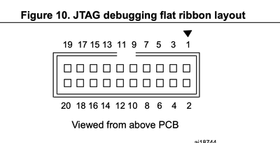

So how did you connect the ST-Link V2 20-pin to your 4-pin header? You must have some sort of custom harness/adapter. Double check to be sure SWDIO and SWCLK are not swapped.

Ok, so what pins are you using on the 20-pin?
You only need 4 connections from the ST-Link v2, GND, VCC, SWDIO and SWCLK. The NRST isn't required, unless you need the software to have the ST-Link hold the device in reset after programming.
If you are now reading ~3.3V from the console now that JP9 is closed, that leaves the 2 SWxxx pins. So either they are not connected to the 20-pin correctly or the ST-Link V2 is bad. I'm leaning towards the former.

In fact I have connected about 11 ground wires. I saw it says "at least one GND, but because I couldn't connect I put them all. The only guide to read pinout properly is a cutout on a ST link body where 20 pin connector goes. Like the picture above.
