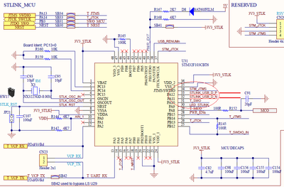

I have a evaluation board STM32L552E-EVAL, and I would like to know what is this part used for ?
I see 2 pins (USB_D_N and USB_D_P) that connect to the STM32F103CBT6
What is it for ? To program the component and debug. Thank you for your answer

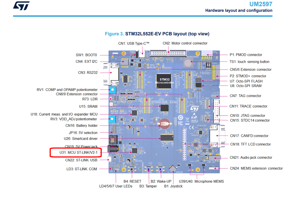

@DYann.1 wrote:the STM32F103CBT6
What is it for ?
That is the ST-Link - for programming and debugging
via: https://www.st.com/en/evaluation-tools/stm32l552e-ev.html#documentation

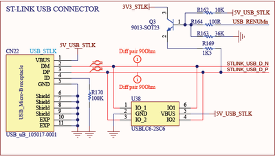

2024-10-24 11:36 AM
It is ESD protection

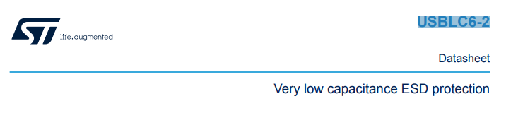

2024-10-24 12:39 PM
@DYann.1 wrote:what is this part used for ?
What part - the USBLC6-2 ?
Its datasheet tells you what it's for:
https://www.st.com/resource/en/datasheet/usblc6-2.pdf
via: https://www.google.com/search?q=usblc6-2sc6

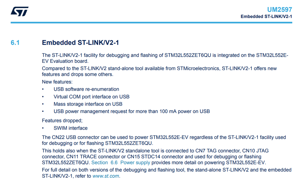

I'd have thought this would have been readily obvious, the on-board debugger. ST-LINK/V2-1
Provides the USB CDC connectivity to a L552 UART, and an USB MSC to drag-n-drop firmware binaries, as originally used by mbed

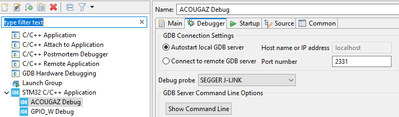

Thank you, in fact I would like to program and debug via J-LINK SEGGER. In fact, on my real card I do not use the ST-LINK (for consumption). Do you know where I can find the information to configure the J-LINK to be able to work under STMCubeIDE ? I can see some information but it's not very clear for my.

I will look at this link. I can work with the J-LINK with my STM32L552xx evaluation card but I still need the ST-LINK usb connector otherwise it doesn't work under STM32CubeIDE. I just need to select J-LINK :
So according to your previous answer, I guess ST-LINK usb is for programming and J-LINK is for DEBUG, right ? If I remove the ST-LINK usb then it does not work.

@DYann.1 wrote:I guess ST-LINK usb is for programming and J-LINK is for DEBUG, right ?
No, not at all.
Both J-Link and ST-Link are full programmers and debuggers.
