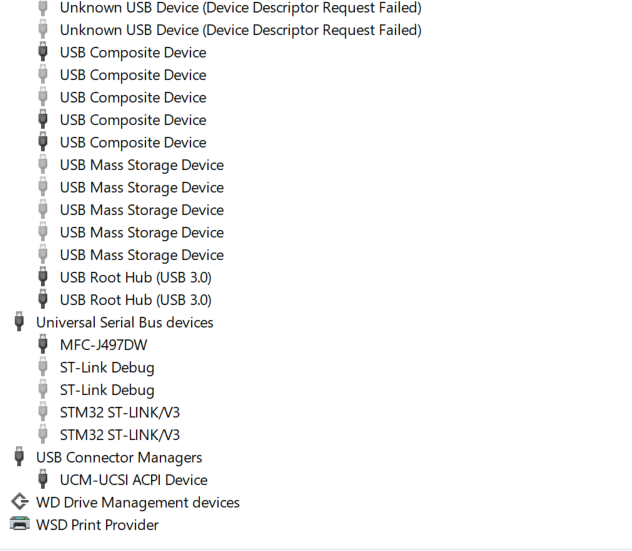

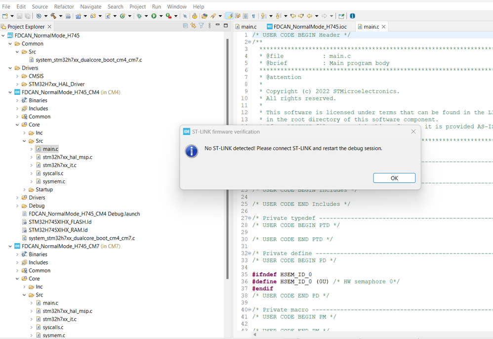

Software side -IDE,MX files okay except when I get to debug configuration - Error" no
st link " drivers exist in Device Manager ; hook up to power CN15 on H7451 ; Windows 11 system

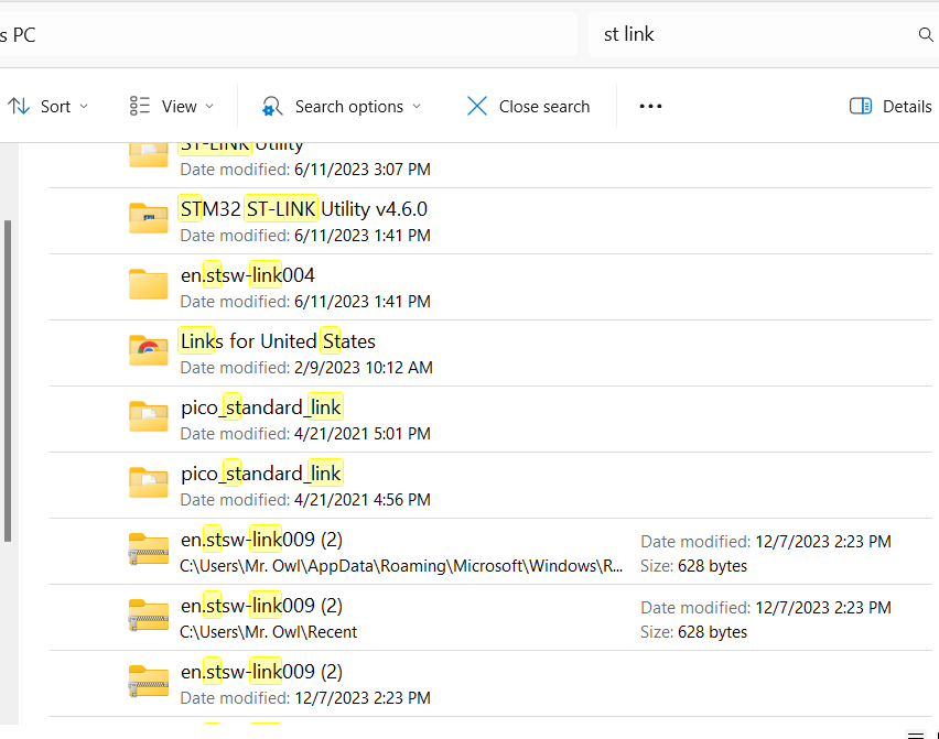

Downloaded St link 0009 latest - followed wizard everything okay; ( maybe it matters what directory the amd64 is in ?

This board has on-board ST-LINK. There are some badly detected USB devices in the dev. manager. Check the USB and power cables. Check the board connector and any jumpers that can affect ST-LINK or power supply.

Do you have a genuine programmer?
Can you connect with STM32CubeProgrammer?

Oh nevermind, you clearly have a genuine ST board. The part about trying to connect with STM32CubeProgrammer is still relevant.
You need a programmer to program. The IDE says it can't find one.
STM32CubeProgrammer is the software that is used to connect.

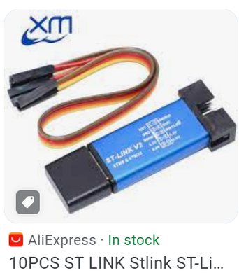

If you do have a programmer and it looks like this, it's not a genuine programmer and is subject to not work well with ST tools.

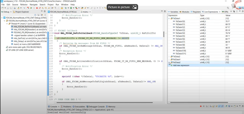

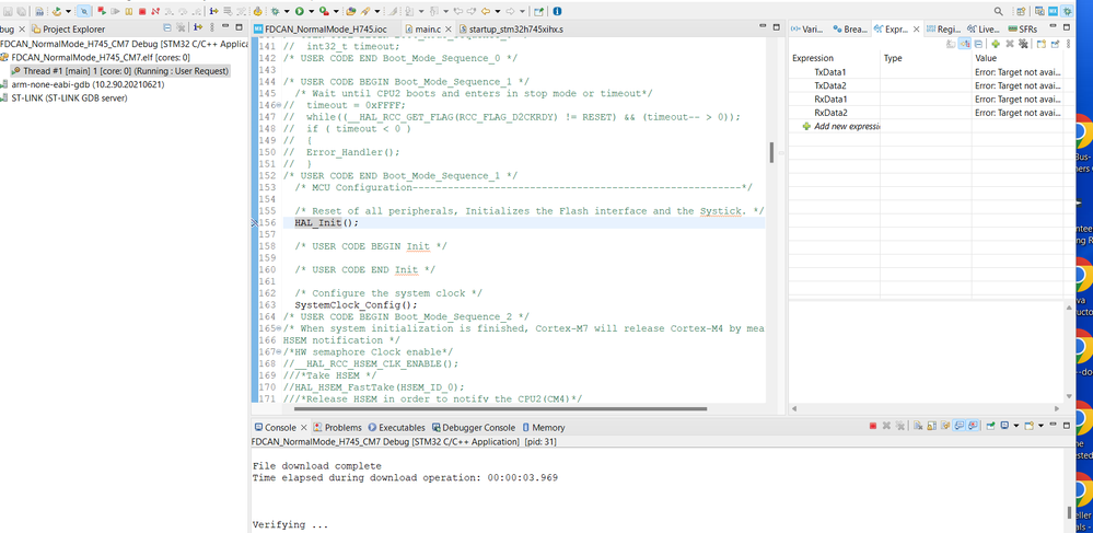

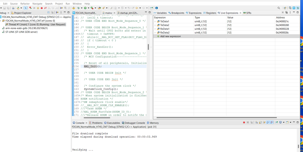

However " in main.c cm7 after creating breakpoint at line 156 like the ( see below pic"s for remaining text)
video and populating the " expression" then hitting resume button - no response - see attached - can't create the data like that in the video - last pic

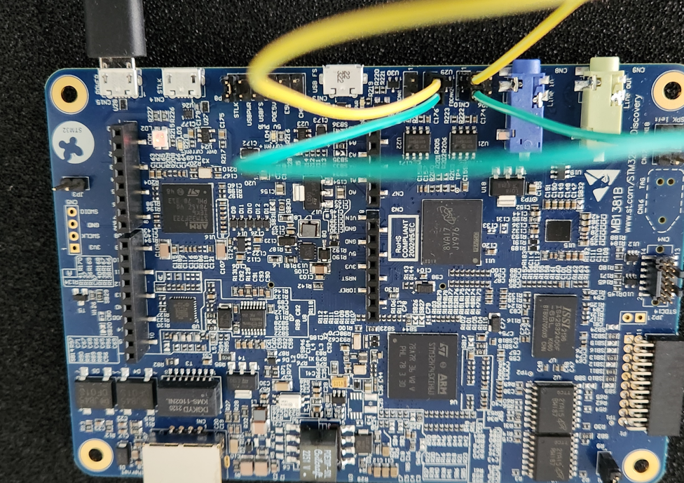

Any guidance would be appreciated. I'm powering thru the CN14 SLTK /USB connector so far so good up to that point
