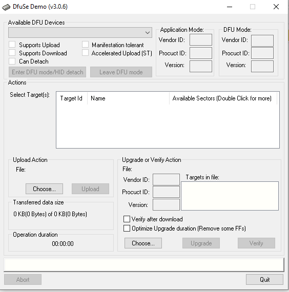

I downloaded that package (en.stsw-stm32080) under Windows 10 and it comes up with not finding a device (I had BOOT0 strapped to Vdd)
2020-10-29 11:12 AM
Board would need powering, you'd have to see the device in Device Manager
