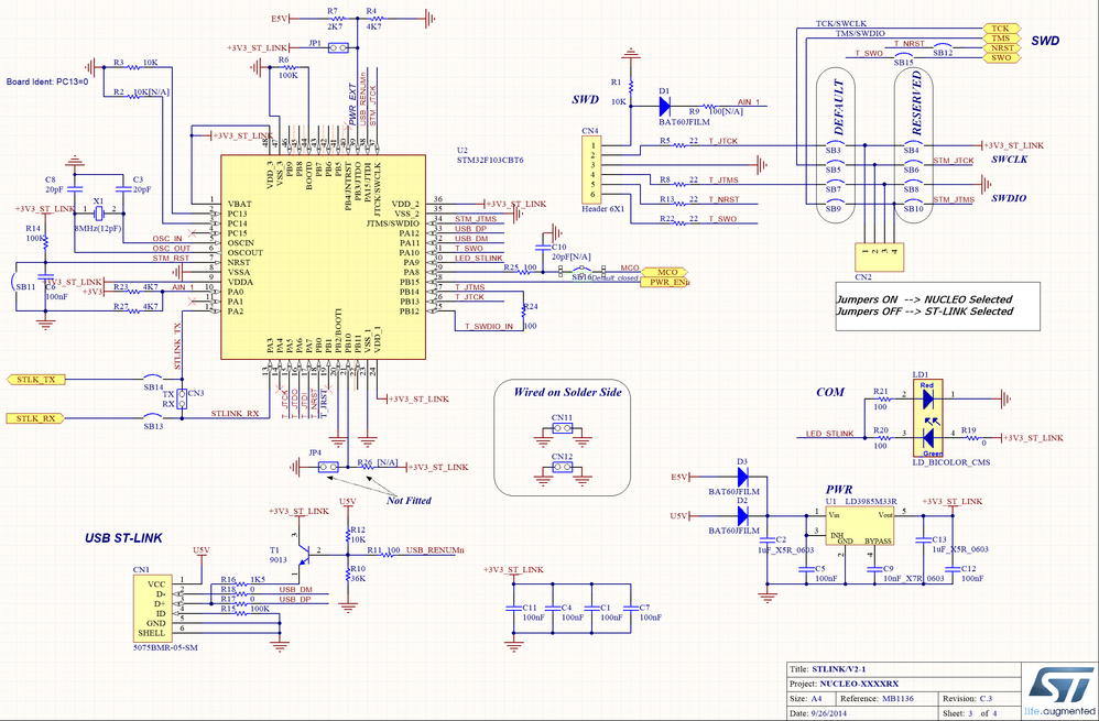

We are trying to create a testing jig for STM32 MCU's where we will be having a on board STlink. We are using STM32F103CBT6 for this purpose and for schematic, we have referred STM32 LoRa Discovery board. There it is noticed that pin39 ( JTDO/PB3) is connected to voltage divider giving out 3.17 . There is also a option for jumper connecting to 3V3.
What is the purpose of this pin. ?
Why should we make this connection?
Where shall we find out description of the working of the ST link FW?
Also what is the purpose of PB15 (PWR ENn) ? Looks like it is turning On /Off the power switch . Why it is required?

Likely there to measure interface voltage.
Don't expect much support here, this is not a legal/permitted use of the IP.
For onboard module look at ST-LINK V3MODS board.
