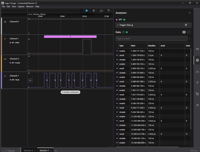

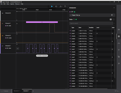

Regardless of the data I send, I consistently see a doubling of the value on my logic analyzer. For example, sending 6 results in seeing 12 displayed. It seems like a constant shift is happening, and I'm unsure of the cause.

i cannot see much from your LA pic...too small.

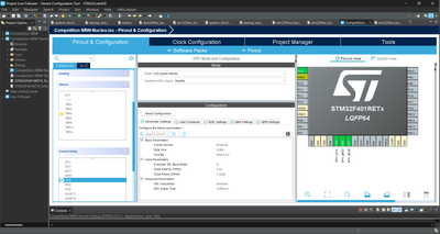

But ... seems, your LA is set on falling edge, while you set in Cube rising edge (1. edge);
so try setting both the same : set in Cube "2. edge" - and see.

2024-06-27 1:14 PM
Sorry for the small size of the image, but you're right I set the clock phase to 2 Edge and it's working fine.
Thank you @AScha.3 !
If it's okay for you to explain it to me, why 1 Edge is causing extra 0 ?

Hey, its shifting in at the edge, you set. So anything might come out, 0->1 , or 1->0 , on all bits; so shifting the whole "result" up or down, depending on the error.
Wrong is wrong...the SPI basically is not very complex, but the point of decision is important: 1 or 0 now .
So if you set this wrong...it might work, sometimes, depends on timing, or never.
But to see this, you need a scope (or LA) with much more resolution, than the signal, then you know, what happens.
Or just try...not so many possible settings. (only 4 .. rising, falling, 1. or 2. edge)
