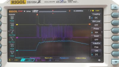

Also I dont know why is the voltage levels of the clock seen as 30V ?
I am not even supplying the same

If you don't tell us which SPI signals we see, the picture doesn't help much.
30V: scope thinks probe is set to 10:1, but probe is set to 1:1.
